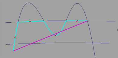

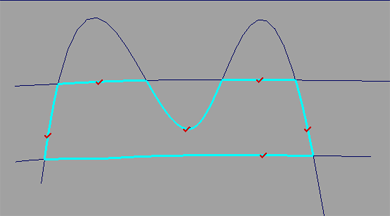

Create a more complex shape
Certain shapes require selecting a curve in more than one location. In the example below, let’s say we want to create a Shape Fill for the region outlined in red.
(This workflow also applies to any of the Paint > Shape > tools).
  1. Choose Paint > Shape > Make Image Shape .
    The Shape Editor opens.
  2. In the Shape Editor, turn off Shape Outline so that only the fill is visible.
  3. Select each curve segment that forms a boundary of the shape region. Picking the same curve in more than one location is allowed.
    Small check marks show the points where you clicked. A thick line marks the outline of the shape defined so far.
  4. Once you have finished selecting the boundaries, press the Accept button.
    The correct shape is created.
