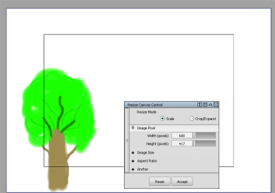

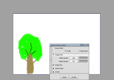

    • Width and/or Height in real-size units (in or cm)
    • Pixels per in/cm (resolution)
    A black outline shows where the edges of the resized canvas will be.
  6. Press the Accept button.
  7. Click OK in the confirm box.
    The canvas is scaled with respect to its center point. The content of the image layers is also scaled to fit the new canvas size.
