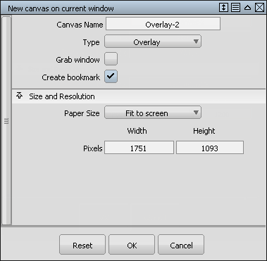

  1. Click the view you want to create a canvas plane on and choose Canvas > New Canvas.
    The option box opens. If you select a brush and click in a view that does not contain a canvas plane, Alias automatically opens the New Canvas option box, prompting you to create a default canvas plane.
  2. Set the Orientation (view window), Background layer color, Paper size and resolution for your canvas, then click OK.
    A blank canvas plane containing one canvas layer and a background layer is created in the view you specified. The new canvas appears in a special Paint window, on top of the regular view window, ready for sketching.
