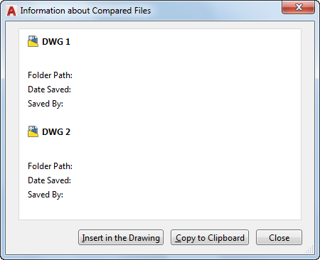

COMPAREINFO opens the Drawing Information dialog, which allows you to either insert the property information of the two drawing files, as a table, into your current drawing or copy the information to your Clipboard, as text.

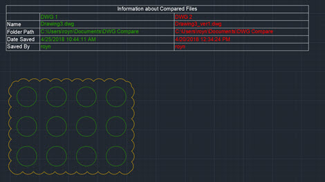

The following sample image shows the property information, of the two drawing files used for comparison, inserted as a table in the comparison result file.
