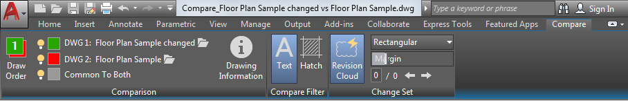

Displays the various options for working with your comparison result drawing.
The following options are displayed.
When you select two drawing files for comparison and click compare, the Compare Contextual tab is displayed on the ribbon.
Controls the display order of overlapping objects in the compare result drawing.
Displays the first DWG file name.
Displays the second DWG file name.
Displays information about the compared drawing files. You can either insert the information in to your drawing or copy to your Windows clipboard.
Controls whether text objects are included in the drawing comparison.
Controls whether hatch objects are included in the drawing comparison.
Displays a revision cloud around each change set in the compare result drawing. Change sets are the same, whether or not revision clouds are displayed.
Creates a single rectangular revision cloud around each change set to show the changes.
