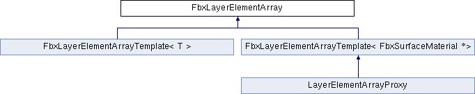

FbxLayerElementArray is the base class for FbxLayerElementArrayTemplate, it provides lock handling and data array manipulation of the data buffer for FbxLayerElement.
Definition at line 332 of file fbxlayer.h.
Inheritance diagram for FbxLayerElementArray:Public Types | |
