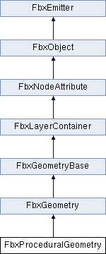

+ Inheritance diagram for FbxProceduralGeometry:
