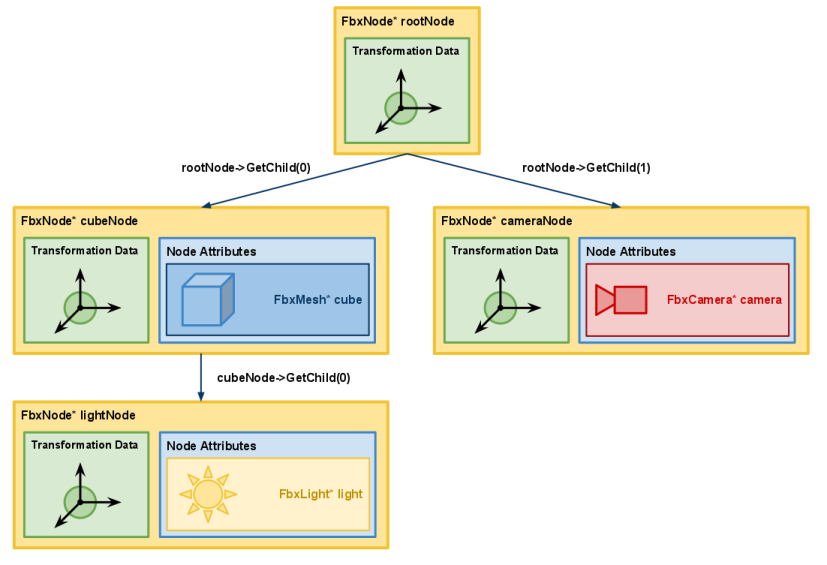

Nodes are organized in a hierarchy such that the position, rotation and scale of a node is described in relation to its parent's coordinate system. For example, in the diagram below, if the cubeNode is translated by 4 units along the rootNode's x-axis, the lightNode will also be affected by this translation. However, cameraNode will not be affected by this translation because cameraNode is not a child of cubeNode.

As mentioned in Exporting a Scene and FBX Scenes, the root node of the scene is not saved when the scene is exported. Only the recursively descendant children of the root node are exported with the scene. In the diagram above, assume rootNode is the root node of a scene. When the scene is exported, rootNode will not be saved. However, cubeNode, lightNode, and cameraNode will be saved to the file, along with their node attributes.

In the diagram above, the node attribute of FbxNode* lightNode is a FbxLight. The position of FbxLight* light in the scene will therefore depend on the cumulative transformations applied to each node from FbxNode* rootNode to FbxNode* lightNode.
