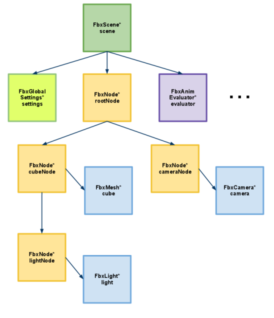

The FBX SDK scene graph is abstracted by the FbxScene class. The scene is organized as a hierarchy of nodes (FbxNode). The root node of the scene is accessed via FbxScene::GetRootNode(). A scene element, for example, a mesh, a light, or a camera is defined by combining a FbxNode with a subclass of FbxNodeAttribute. For more information, see FBX nodes and FBX node attributes.
During an export operation, the root node of a scene is not exported to the file. Only the children of the root node are exported to the file. As such, it is not recommended to associate anything to the root node that should be saved to a file.
As illustrated in Managing memory with the FBX SDK manager, a FbxScene is created by invoking the FbxScene::Create() function. A new FbxScene contains a root FbxNode, and a FbxGlobalSettings object with a default configuration.

FbxScene* lScene = FbxScene::Create(lSdkManager, "Scene Name");Scene elements are created using a reference to the FbxScene in which they belong. In doing so, the scene will be exported with all the elements which were created with it. In the following sample, a node is created with a reference to the FbxScene, and attached to the root node of the scene.
// Get the root node of the scene.
FbxNode* lRootNode = lScene->GetRootNode();
// Create a child node.
FbxNode* lChild = FbxNode::Create(lScene, "child");
// Add the child to the root node.
lRootNode->AddChild(lChild);The scene's axis system, system units, ambient lighting, and time settings are defined in its FbxGlobalSettings object. This object is accessed via FbxScene::GetGlobalSettings().
