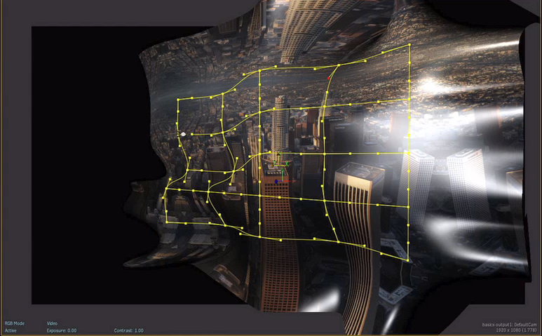

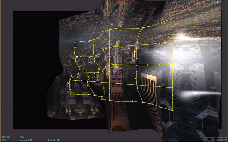

Extrapolation Section
Using the extrapolation sliders, you can extrapolate the texture beyond the geometry, in X and Y. You can assign negative extrapolation values and effectively crop the texture. The extrapolation is in mirror mode, by default. You can change this by adding a Diffuse node in the Action schematic. When working with an Extended Bicubic surface, you can choose between Linear Extrapolation and Smooth Extrapolation. Smooth extrapolation produces a more organic deformation, extrapolating the deformation created by the vertices and tangents, while Linear extrapolates the surface in a straight line after the last vertices, in the direction of the tangents.
Linear extrapolation

- Extrapolation box
- Available for extended bicubic surfaces only, and when the size offset fields are not at 0. Select Linear to extrapolate the surface in a straight direction. Select Smooth to extrapolate smoothly based on the position of the vertices of the surfaces.
