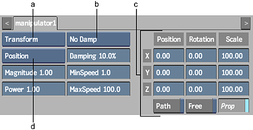

You use the Particle Manipulator menu to select the type of manipulator, its speed and position, and the power of its falloff. To access the Particle Manipulator menu, double-click the particle animator node in the schematic, or follow the tab population rules for the Object menu (see Populating Menu Tabs of Selected Objects).
(a) Manipulator Type box (b) Damping box (c) Axis controls (d) Influence box
The particle manipulator controls are described as follows.

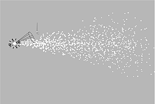

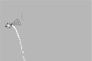

By selecting Speed in the Influence box located on the Particle Manipulator menu, each particle's speed is changed with each pass by the selected manipulator.
When you influence by position, the position is applied only once. For example, the following figure uses a gravity manipulator to illustrate the difference between position and speed. The gravity manipulator on the left uses the default gravity manipulator with a magnitude of 4 and with position as the influence. The gravity manipulator on the right uses exactly the same settings except the influence is set to speed.

| Control | Description |
| Position | Use the Position X, Y, and Z fields to displace each particle along the X, Y, and Z axes. |
| Rotation | Use the Rotation X, Y, and Z fields to rotate each particle. Each particle is not the centre of its rotation. Particles rotate around the manipulator's axis. |
| Scale | Use the Scale X, Y, and Z fields to increase or decrease the speed or position of each particle along the X, Y, and Z axes. For example, if speed is the selected influence, a Scale X of 100% has no effect while a Scale X of 105% increases the speed along the X axis by 5% with each pass. Enable Prop to proportionally scale the axes. |
Enable the Path button to animates the position of the axis using a spline drawn in the scene. Disable Path to animate the position of the axis using explicit animation.
