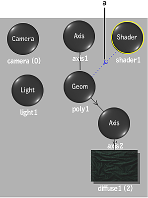

The selected object is connected to the shader by a blue dotted line with an arrow, and only the selected objects are affected.
(a) Shader inclusion link

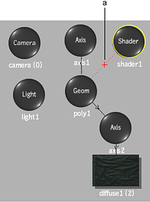

Excluded surfaces are connected to the shader by a red dotted line with an “X”, and they are not affected by the shader.
(a) Shader exclusion link
