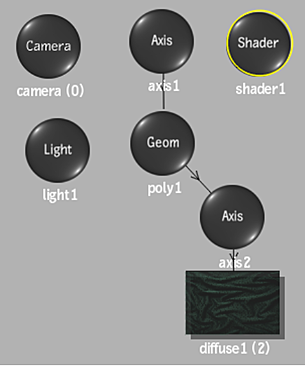

To add a shader to the scene:
A shader is added to the scene. If you select a surface or 3D geometry in the scene before adding the Shader node, a shader inclusion link is automatically applied. You can also apply inclusion and exclusion links manually. See Applying a Selective Shader.
Unlike many objects, a shader is not a confined object in the perspective space, and therefore is added without an axis.
