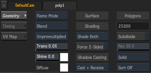

You can change and animate parameters such as the colour, specular highlight, shine, and transparency of 3D models. You set these parameters using the Geometry menu. To access this menu, double-click a Geometry node in the schematic, or follow the tab population rules for the Object menu (see
Populating Menu Tabs of Selected Objects).
Blending Settings
- Blend Type box
- Select whether to use Flame or Photoshop blend modes.
- Blend Mode box
- Select how the 3D model and the scene are combined. The available list of modes depends on the selection in the Blend Type box.
See
Surface Blending Modes.
- Transparency field
- Displays the transparency level of the 3D model. Editable.
- Shine field
- Displays the intensity value of the specular highlight. When this value is zero, the specular highlight is disabled. Shine affects both size and intensity. Editable.
See
Creating a Specular Highlight on a Model.
- Specular colour pot
- Displays the colour of light reflected by the 3D model's surface. To enable the specular highlight, the Shine value must be larger than 0. Editable.
- Diffuse colour pot
- Displays the diffuse colour. Editable.
Surface Settings
- Shade Order box
- Select the drawing priority of the 3D model normals.
| Select:
To draw the polygons:
| Shade Both
That are both facing and opposite the camera.
| Shade Front
Facing the camera last.
| Shade Back
Opposite the camera last. This option is especially useful for semi-transparent models
- Force 2-Sided button
- Enable to have lights in the scene light both the inside and outside of the geometry (when shading is turned on).
- Shadow Casting box
- Select how the selected geometry object will be affected by a Shadow Cast object in the scene.
See
Surface and Geometry Shadow Casters.
Polygons Settings
- Polygons field
- Displays the number of polygons in the 3D model. Non-editable.
- Subdivide button
- Enable to create high-quality shading for polygon models.
- Resolution field
- Displays the geometry resolution of the 3D model. Active when Subdivide is enabled. Editable.
- Wireframe box
- Select a wireframe option for the 3D model. When you render the 3D model with Wireframe or Original Wire selected, it retains its light, shading, and texture attributes.
| Select:
To:
| Solid
Disable wireframe for the 3D model (filled polygons are drawn).
| Wireframe
Display the model as a wireframe outline (triangular polygons only).
| Original Wire
Display the model as a wireframe outline (original mesh; any polygon type). May be useful for imported geometries.
- Sort box
- Select how the 3D models contained in the scene are drawn.
| Select:
To:
| Sort Off
Not apply any sorting.
| Sort All
Sort all objects according to the Z-order and the order of the object group (Material ID).
| Sort Transparency
Give transparent objects lower priority than opaque parts, to solve transparency issues if the scene contains semi-transparent 3D models.

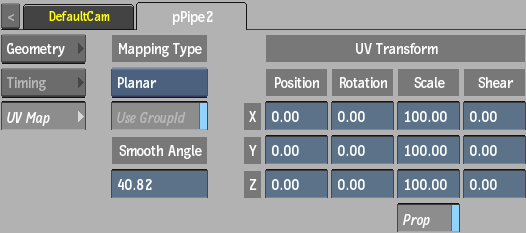

UV Map Settings
Use the UV Mapping settings to select how the UV coordinates of an attached displace, normal, or diffuse node are mapped to the 3D model. You can also apply axis transformations to the UV map. These transformations are different from the settings of the parent axis in that they transform the axes of the actual UV map coordinates.
- UV Mapping Type box
- Select the type of UV mapping to apply to the attached node.
When a Displace or Normal node is attached to a geometry, you may need a UV mapping type other than Default for the displace or normal pattern to have any effect on the geometry.
Note: When a Diffuse node is attached to a geometry, you must select Wrap from the Mapping box in the Diffuse menu to be able to use the UV mapping settings. See
Diffuse Mapping.
- Use GroupId button
- Enable to respect GroupId information in an FBX file created in 3ds Max.
- Smooth Angle button
- Enable to override existing normals in the geometry, then use the Smooth Angle field to change the value.
- Smooth Angle field
- Displays the angle at which the edges of normals become hard. Changes to this field only affect the shading of the displacement, and not the shape. Editable.
- Position X field
- Displays the position of the X axis. Editable.
- Position Y field
- Displays the position of the Y axis. Editable.
- Position Z field
- Displays the position of the Z axis. Editable.
- Rotation X field
- Displays the rotation of the X axis. Editable.
- Rotation Y field
- Displays the rotation of the Y axis. Editable.
- Rotation Z field
- Displays the rotation of the Z axis. Editable.
- Scale X field
- Displays the scale of the X axis. Editable.
- Scale Y field
- Displays the scale of the Y axis. Editable.
- Scale Z field
- Displays the scale of the Z axis. Editable.
- Prop Scale button
- Scales the X, Y, and Z UV axes proportionally.
- Shear X field
- Displays the shear of the X axis. Editable.
- Shear Y field
- Displays the shear of the Y axis. Editable.
- Shear Z field
- Displays the shear of the Z axis. Editable.
Note: The UV Transform fields are only available if a Mapping Type other than Default is selected.
