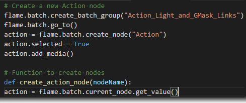

Python scripting:
  • Timeline
  • Media Panel
  • Render Node
  • Camera 3D

Python Hooks
Hooks on Batch Iterate. Two new python hooks have been added to the batchHook.py file: batchSetupIteratedPre() and batchSetupIteratedPost(). The hooks are respectively called before and after the Iterate or Iterate As functions are performed from the user interface or the python api.
Python API
More control. The Python API augments it capacity to control the application by extending to new areas.
In Action:
In Batch:
In Media Panel:
In Timeline:
For additional details, see the Python API documentation.
