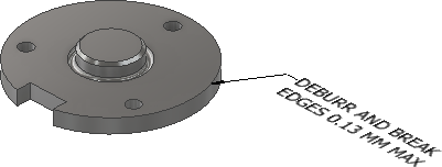

Use the text commands to add leader text and note text to the 3D model.
What's New: 2018, 2018.1, 2019.2
Leader Text is created with a single-segment leader by default. To create more leader segments, start the command, right-click, and click Single-Segment Leader to unselect the option.
Notes panel
Leader Text
Change the required values and then click OK.

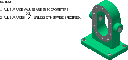

General Note
A General Profile Note adds control for faces not identified with a tolerance feature annotation.
Notes panel
Insert/Edit annotation icon to specify the tolerance value.
The note is displayed normal to the view.
To edit a General Note or a General Profile Note:
