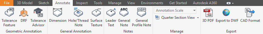

Use commands available on the Annotate tab in a part or assembly file to add 3D annotations to your model.
Use the Tolerance Feature command in a part file to add GD&T annotations to your model. Use the Tolerance Advisor to help you understand the state of your model and manage the Tolerance Feature annotations.

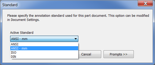

Setting 3D annotation units and standards
Changes to Document Settings Units tab do not affect 3D annotations. Click Document Settings Standard tab and then specify the Active Standard to set the units. If no active standard exists the first time you use a 3D annotation command, you are asked to choose a standard.

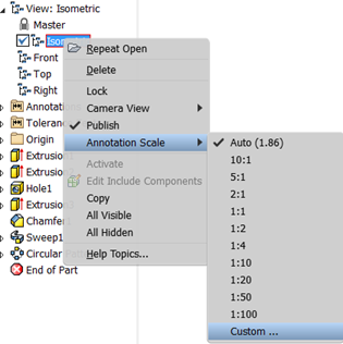

Set the view annotation scale
The scale of 3D annotations is independent of the Annotation Scale option in the Application Options > General tab and can be a different size in each view. Right-click a view in the browser and select Annotation Scale to set the scale.
You can also control the annotation scale of the active view by selecting the Annotation Scale drop-list in the Annotate tab > Manage panel. Use the Auto setting to let the system control the size, or choose Custom to define a scale not available in the list.
Tip: Click Custom to open the Edit Annotation Scale dialog box and specify a custom Annotation Scale value.

Use View representations to control annotation visibility and scale
Set the visibility and scale of model annotations specifically for each design view and then save the current camera. By default, when you create annotations in the active design view, the annotations are added to all existing unlocked design views.
The scale of 3D annotations is independent of the Annotation Scale option in the Application Options > General tab. Right-click a View representation to set the Annotation Scale.
