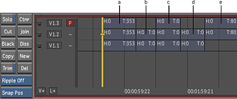

The following example illustrates how top vertical priority determines which shots are displayed, played out to tape, and rendered. It also illustrates how the displayed shots come from various layers throughout the course of the timeline. For simplicity's sake, in this example, there are no muted layers and no shots assigned with shot priority.
(a) Shot 1 (L3)  (b) Shot 2 (L2)  (c) Shot 3 (L3)  (d) Shot 4 (L2)  (e) Shot 5 (L3)  
You can use the timeline information field to verify the layer and shot being displayed at any given point in the timeline. See Monitoring the Location of the Current Frame. For example, in the following screen capture, the shot being displayed is shot 3 on Layer 2, and the current frame is frame 183.

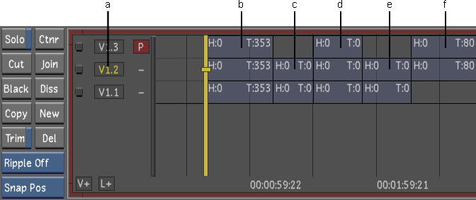

The following example illustrates how a muted layer is used within a multi-layer timeline to determine what shots are displayed in the Storyboard and Player when the Top Vertical Priority rule is applied.
(a) Muted layer  (b) Shot 1 (L3)  (c) Shot 2 (L1)  (d) Shot 3 (L3)  (e) Shot 4 (L1)  (f) Shot 5 (L3)  
In this example, Layer 2 is muted. Therefore, only the shots in Layer 1 and Layer 3 are active.
To mute a layer:
  1. Do one of the following:
    • Ctrl-click the name of the layer you want to mute (e.g., V1.L1).
    • Shift+M to mute the layer with focus.
    The layer name indicator turns yellow.
To unmute a layer:
    • Ctrl-click the name of the layer you want to unmute (e.g., V1.L1).
    • Shift+M to unmute the layer with focus.

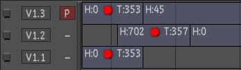

When you work in the Top Vertical Priority mode (Solo is disabled), you can assign priority on a shot-by-shot basis. A 'priority shot' in a given layer is displayed even if there are shots in the layers above it in the timeline. In the case where there are multiple priority shots in a vertical stack, the priority shot with Top Vertical Priority is displayed or updated accordingly in the Player. Furthermore, the Storyboard thumbnails are updated according to priority after an initial refresh. Lustre represents a priority shot in the multi-layer timeline as a shot with a red dot.
The following behaviours are expected when using the shot priority function:
Danger: If you mute a layer that has a priority shot, that shot is not displayed, played out to tape, nor rendered.

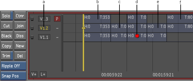

The following example illustrates shot priority in the multi-layer timeline.
(a) Muted layer  (b) Shot 1 (L3)  (c) Shot 2 (L1)  (d) Shot 3 (L1)  (e) Shot 4 (L1)  (f) Shot 5 (L3)  
In this example, Layer 2 is muted and Shot 3 in Layer 1 is a priority shot.
To assign shot priority to a shot:
  1. In the multi-layer timeline, Shift+right-click the shot (in the desired layer) to which you would like to assign priority.
    A red dot appears on the shot.
To assign shot priority to the shot in focus:
  1. In the multi-layer timeline, make sure the positioner and its focus point are focused on the shot to which you apply priority.
  2. Press Shift+\.
    A red dot appears on the shot in focus.
