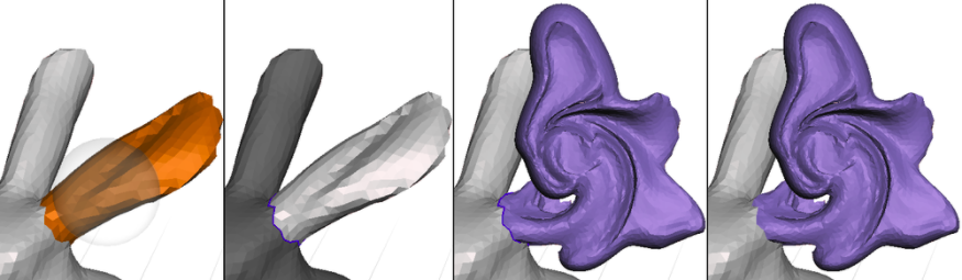

The images below show how to use this workflow to isolate a region for 3D sculpting. The ear is Separated, sculpted, and Combined, and then Close Cracks merges the meshes into a single continuous shell. Note that during the sculpting the Fixed Boundary filter must be checked to precisely preserve the boundary loop.
