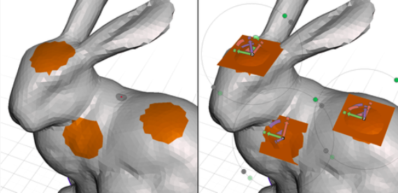

The Fit Primitive tool is used to create new mesh elements based on an input selection. The tool supports a variety of mesh elements, from simple primitives like squares and cylinders (hence the name) to more complex computational-geometry items like convex hulls. Using this tool, you can even do quick reverse-engineering tasks. An example of Fit Primitive is shown below. Three areas of the bunny are selected, so three squares are fit, one to each area.

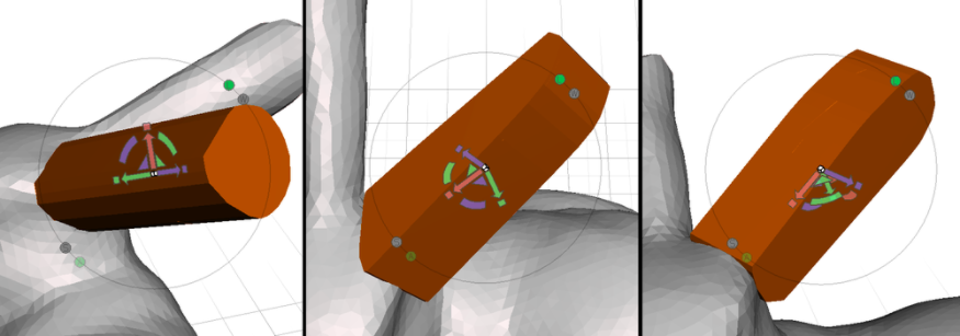

Cylinder mode fits a cylinder to the selection. One (current) issue with the Cylinder mode is that our fitting algorithm is often confused if the selection length and diameter are roughly similar. The images below show an example, where initially the cylinder has the incorrect orientation (middle). In this case you can use the 3D widget to rotate the cylinder, and it will in most cases snap to the orientation you intended, as shown in the image below on the right. If not, you may need to modify your input selection.

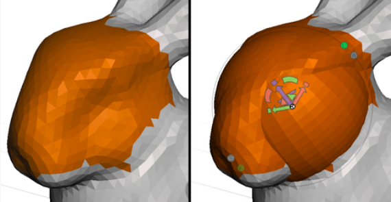

The Sphere best-fit mode tries to find a sphere center and radius that best fits the input selection. The images below show an example.

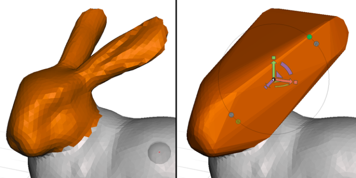

The Linear Sweep mode is more complex than a simple geometric primitive. In this mode, we first find the best-fit bounding box. This gives us an axis direction. We then project the selected vertices onto the plane perpendicular to this axis, and find the 2D Convex Hull of these on-plane points. This convex hull gives us a 2D polygon we can sweep along the axis, to the extents of the selection projected onto the axis.
The image below shows usage of Linear Sweep mode, applied to the bunny ear. The first image is the default sweep. However as we use the 3D widget to rotate the primitive, we are actually rotating the projection axis, and then the 2D convex hull and extents are recomputed dynamically. So, in the next two images, we have re-oriented the axis (which is alined with the blue arrow in the 3D widget), to produce different linear sweeps.

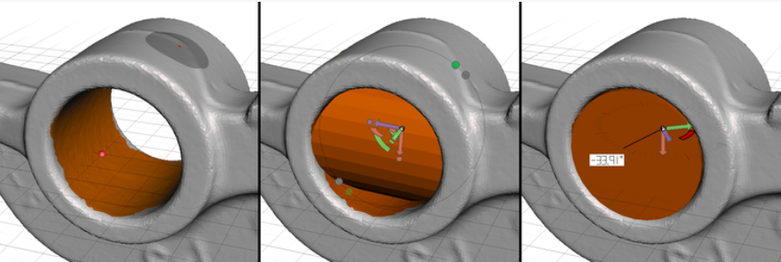

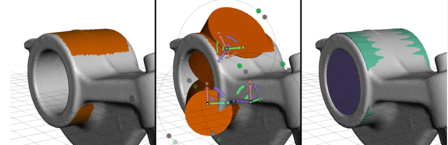

In the example below, we want to fit a cylinder to an area where portions of the cylinder are attached to other shapes. We have selected as much of the cylinder as possible, which has resulted in several disconnected selected regions. By default, the Fit Primitive tool will fit a cylinder to each separate region (middle). If the Single Primitive box is checked, then a single cylinder will be simultaneously fit to all the selected triangles. The result is shown on the right (overlapping with the initial shape).

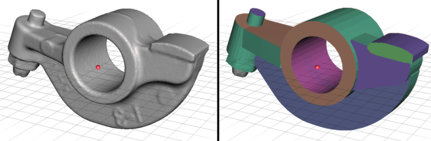

In the example below, we have used multiple Fit Primitive operations (as well as a few Boolean operations) to construct a set of simple shapes and primitives that approximate the scan on the left. This kind of basic approximation can be combined with operations like Edit > Attract To Target to create structured approximations to scan models.
