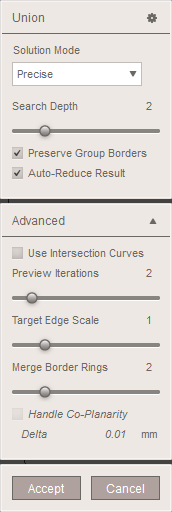

One pro and con of our method is that it does have various parameters you can manipulate, shown in the property panel below. These are useful to improve quality and also handle situations where the default settings result in failures. We explain each parameter below.

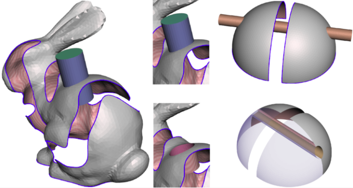

In fact, this growing process is nearly identical to that in the Edit > Join tool. However, instead of the growing being unconstrained in 3D space, we actually are sliding the boundaries on the underlying input surfaces. Because we are taking this mesh-editing approach, we can handle some bizarre cases. For example, the images below show "Booleans" applied to objects that are clearly not even remotely solid!

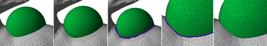

So, now that you know a bit about what is going on inside this tool, we can explain the parameters. The Search Depth parameter is used in the initial remeshing pass, before we delete the intersecting triangle strips. We add some triangles because we want to have enough density to resolve any ambiguities after we delete the strips. We need to be able to match up closed loops on either side. In the example below, this doesn't initially happen - the near-coplanar region results in two loops on one side and one on the other.
This is the most common failure mode of our Boolean. When we have a failure, we go back to the remeshing and try again, at a higher density. The Search Depth controls the number of increase-and-retry iterations. In this example we have to set it to 6 to get a valid result. There is no harm in setting it high, as we stop at the first valid result.
However, each additional iteration is slower than the last. In some cases it might be quicker to go in and manually remesh a problem area yourself, either with the Remesh tool or sculpting brushes.

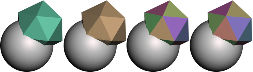

Preserve Group Borders
One aspect of our Booleans you will quickly discover is that sharp edges are a weak point. This is due to the remeshing - in fact you will see the same artifacts in the Edit > Remeshtool. However, just like in Remesh, we can preserve group borders. So, if your sharp-edge object has face groups (which you can usually generate using Generate Face Groups), and Preserve Group Borders is checked, then the result will be significantly improved. In the example below, the leftmost two images do not have face groups, while the right images do.

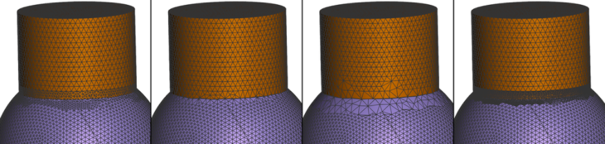

As mentioned above, we need to Remesh the input objects around the intersection curves, to make sure enough triangles are available. If you are working with low-polycount objects, this can result in huge numbers of additional triangles, as shown in the example below. When Auto-Reduce Result is enabled, we try to apply our Reduce algorithms as a post-process. This often cleans up areas of very low-quality triangles (visible in middle image below), so we do this by default. However, if you find that your objects are being mangled, you might try turning this option off.

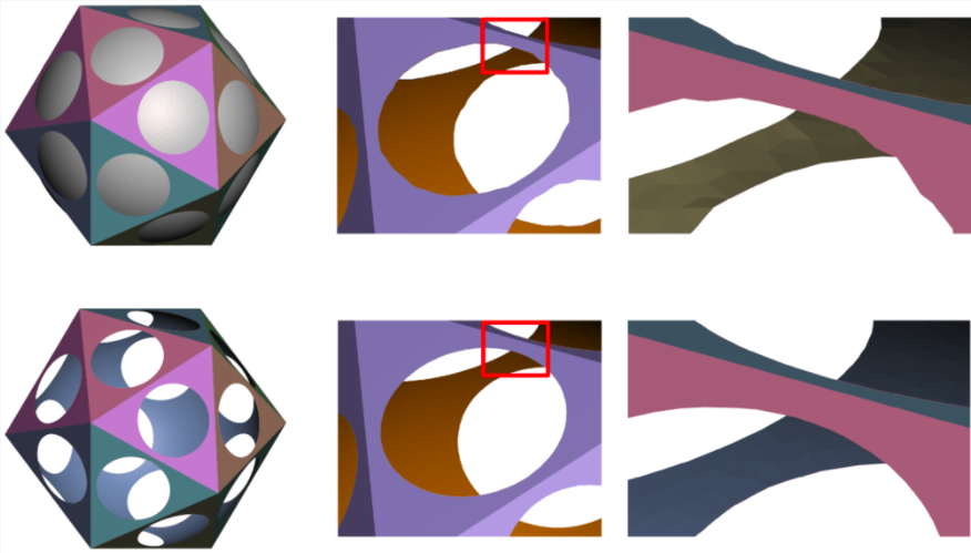

In our description above, we explained that we close the cracks we have introduced by growing the open boundaries towards each other. This works most of the time. However in some cases where the input surfaces are nearly co-planar, the boundaries can merge before they reach the actual intersection curves. When the Use Intersection Curves option is checked, we explicitly compute the intersection curves, and grow the boundaries towards these curves. This can significantly improve the result, as shown below (lower row).

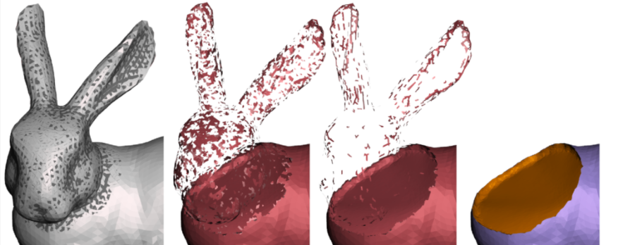

This option enables super-experimental features of our Mesh Boolean. Co-planar regions are problematic for mesh booleans in general. However even worse is nearly-coincident regions, where there are thousands of small intersections. An example is shown in the image below, where a remeshed version of the bunny head overlaps the original. A Difference between these two objects produces an incredibly noisy result (which also fails, in this case).
When Handle Co-Planarity is checked, we try to detect and discard these spurious intersections. This detection requires a sort of radius parameter, which is the Delta value. Increasing this value will increase what is considered noise. This is a somewhat unconventional use of mesh Booleans. However it can be incredibly useful if you are trying to compute the difference between two versions of a 3D model that has been remeshed or otherwise resampled. Note that currently this option is only available for Difference operations.

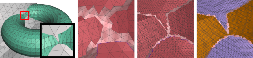

Meshmixer's Booleans can be a challenge on meshes that have poor triangle quality. In particular self-intersections and non-manifold regions near the intersection curves can cause failures. However even simple cases can sometimes go wrong, if you are unlucky and there just aren't enough triangles to resolve an important feature. So, if some area doesn't look right, the best policy is to add more triangles. Virtually every time we get a bug report about Booleans, we can resolve it by Remeshing.
