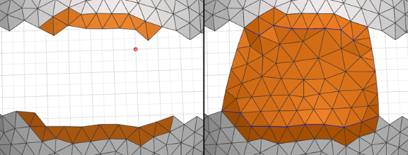

To use the Bridge tool, you must select two separate regions that contain mesh boundaries. Only the boundary edges will be bridged, the actual selected triangles are not modified. See below for an example.
The Bridge property panel is shown below. This panel currently only has one setting, Refine, which controls the number of remeshing iterations applied to the bridge mesh. See the Remesh too for more details. If you set the Refine slider to 0, remeshing is disabled and you will get a minimal-triangulation bridge.
The image below shows an example usage of the Bridge tool. Note that we do not require the same number of boundary edges on either side of the gap. In fact the Bridge tool easily handles large differences in the number of boundary edges on either side.
