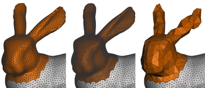

In Relative Density mode, you use the Density slider to specify a percentage change in the edge length. You can request up to a 50% increase or decrease in the average edge length over the input area. In the image below we show the original mesh on the left, Density = 50% (middle image), and Density = –50%.

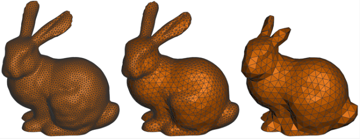

In Relative Density mode, we are trying to achieve uniform edge lengths over the target area. In Adaptive Density mode we try to use non-uniform target edge lengths, to preserve fine details. This really only has a major effect when reducing the triangle density, except that it can also help to prevent important features from being lost when remeshing at similar or higher densities.
You can set the Threshold slider to (roughly) specify how much detail-preservation you want. In fact this value is mapped to an angle constraint, so at very low thresholds, only very flat areas will be modified, while at high thresholds the result will be similar to a non-adaptive remesh.

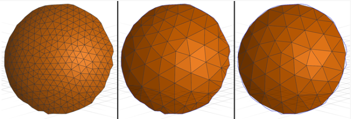

The images above show an initial mesh on the left, an Adaptive Density remesh at –50% (middle image), and the non-adaptive Relative Density result. The Adaptive result does a much better job of preserving features, while still allowing for significantly larger triangles in some areas.

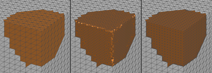

The images above show an input mesh on the left, a Relative Density remesh (middle), and the Linear Subdivision result (right). Note that the Relative Density version has lost the sharp edges, while they are preserved in Linear mode.

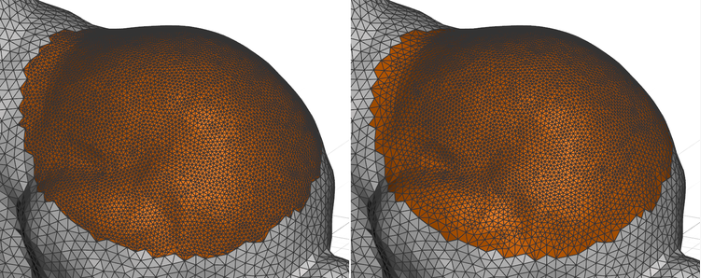

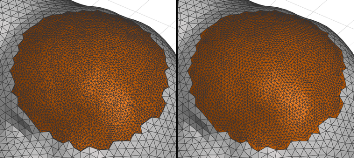

One thing you will notice when remeshing sub-regions of a larger model is that the triangles tend to get ugly at the selection borders. This is because the selection border is a hard constraint: we do not split or collapse any edges along it. To increase or decrease the density right next to the border, we have to use a bunch of sliver triangles.
The Transition parameter allows you to specify a gradual transition from the input border edge length to the target edge length. This transition happens over a band inwards from the selection boundary, and the Transition parameter specifies the width of that band.
The images above show a result on the left without transition, and on the right with transition. On the right you can see that the triangle density changes more gradually around the edge of the orange selected region.

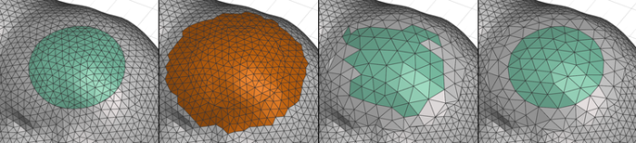

As you become more experienced withMeshmixer, you may find that you start to use face groups to demarcate important regions of your model. This is very useful in many modeling tasks. For example, if you have important feature edges in your model, creating face groups for each patch (like the patches in a B-Rep solid modeler) means you work with your model at a higher level of abstraction. So, when you need to remesh, you don't want to lose those face groups. The Preserve Group Borders checkbox tells the remesher that you want to preserve your group borders.
The images above show, left to right, an area with a facegroup, a selection, a remesh without preserving the group borders, and then finally a remesh with the group border preserved.
Note that the group border is still re-sampled when lowering the density, the shape is just approximately preserved. Currently we do not have an option to enforce a hard constraint on the group borders. To achieve that, you need to separately remesh the interior and exterior of the group (which is easy to do, using the group double-click shortcut in the

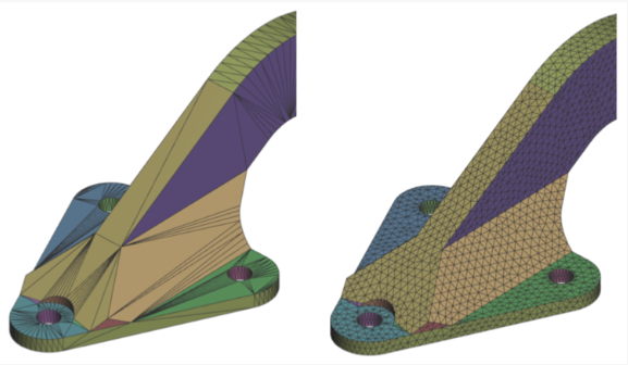

As mentioned above, Preserve Group Borders is also useful if you would like to remesh objects with sharp edges. If your mesh doesn't have face groups already, you can use Generate Face Groups to quickly create a decomposition. The image below shows a common scenario, where the mesh has been exported from a CAD tool. CAD tools often create meshes with minimal triangulations, which do not work well in Meshmixer. Several rounds of Remesh with Preserve Group Borders produces a high quality result. You may find that Adaptive Density mode works better in this kind of situation.

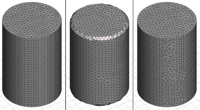

We mentioned above that Face Groups are a good way to create feature boundaries that are preserved during remeshing. If the feature boundaries you care about are sharp edges between otherwise flat/smooth regions, then there is another option that allows you to skip the sometimes tedious step of creating many face groups. When Preserve Sharp Edges is checked, we identify and constrain sharp edges. The image below shows an example where the cylinder on the left (which has no face groups) is remeshed without (middle) and then with (right) Preserve Sharp Edges checked.

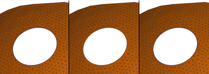

In the images below, we are increasing density from a lower resolution mesh (not shown). The left image uses Fixed Boundary mode. Note the constrained lower-density boundary at the top of the image. In the middle we use Free Boundary mode, which has no constraints. However, one drawback of Free mode is that important internal features may be resampled - in this case the border of the internal circle has been coarsened. In the right image, we use Refined Boundary mode, which allows edges to be split but not collapsed or smoothed. So, the outer border gets a nice upsampling, but the shape of the internal hole is preserved.
