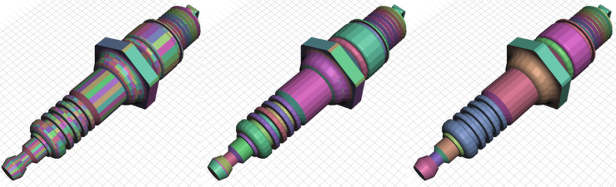

In this first example, we have a complex spark-plug model exported from a CAD tool. For CAD models, Edge Angle mode works best. In this model the tessellation is quite low-res, so the default Angle Threshold picks up each strip of facets on the cylindrical regions (left). As we increase the Angle, there is a point where the rings on the left end are segmented. But at higher thresholds the fillets confuse the clustering, causing that entire area to be merged into a single group (right).

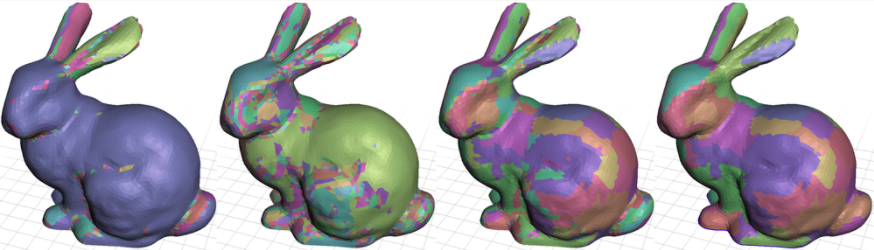

In the next example, we can see how neither of these methods does a great job on the bunny model. The leftmost two images are Edge Angle mode at two Angle Thresholds. The third image is Normal Angle mode - you can see how the clusters are more localized, to some degree. Finally, to get a smaller number of clusters, I increased the Size Threshold in the last image. This sort of result is usually not immediately useful However, it is often possible to quickly mark the groups and join them (with a quick expand-to-groups g and create group Ctrl/cmd-g key combo) into larger regions that may be semantically useful.
