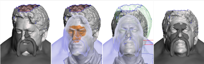

In the following example, we would like to replace the face on an existing model with a 3D scan of a second face. The actual replacement can be done many ways, but first we need to get the scan lined up with the existing head. Align to Target is an ideal tool for this task, however as above, we need to position the scan in roughly the right location for Align To Target to work properly.
In the images below, we show the initial approximate alignment that we set up using the Transform tool, then the selection we used to align, the alignment inside the Align To Target tool, and the final result after accepting the alignment. We will continue to use this example in the Attract to Target tool, to show an easy way to deform the existing face to fit the scan.
In creating the above example, it took several tries to find a good combination of initial rough alignment and selection region. The results of Align To Target are sensitive to both of these factors.
