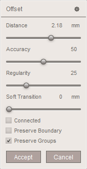

The Offset property panel is shown below. The Distance parameter specifies the offset distance. This can be positive or negative.
The Accuracy parameter controls the precision of the offset surface solution. This is basically controlling the density of the remeshed offset surface; more triangles means a more consistent offset thickness.
The Regularity setting is also a control on the internal remeshing, essentially it controls the amount of smoothing during each remesh pass. Generally more smoothing means a better solution, however high smoothing can also cause thin or small areas to collapse, and then the Offset solution will be incorrect.

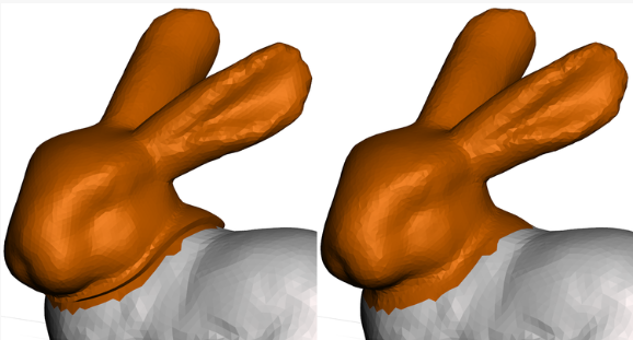

Normally the Offset is a separate surface that we stitch with a tube, very similar to Extrude. However when the Soft Transition slider is non-zero, the behavior is different. In this case we try to "blend" between the original and offset surface. The distance specified by this slider controls the width of the transition band. The image below shows an example of this, with a standard Offset on the left and a soft transition offset on the right. This parameter is very useful if you wish to thicken a thin part.
The Connected checkbox controls whether the Offset surface is stitched to the base surface with a tube (like Extrude) or an offset copy of the base surface (like Extract). Note that in Soft Transition mode, this checkbox is ignored.
The Preserve Boundary checkbox only has an effect on non-connected offsets. When this is unchecked, the boundary is free to move and be remeshed. When checked, the boundary loop is preserved, and its position is defined strictly by normal vector offsets. Note that for large offset distances this will often cause foldovers & artifacts.
Preserve Groups determines whether the input groups are maintained in the Offset surface. If so, they group boundary loops are constraints on the internal remesher, which can reduce the quality of the Offset surface. When this setting is un-checked, each offset surface is assigned a new face group.
