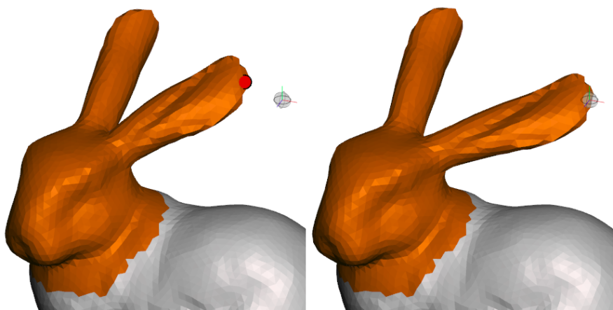

The images below show an example. To drop a control point you left-double-click on the selection, and a red sphere will appear. You can only place control points at vertices. You can then move the control point by left-click-dragging. Currently we do not have our 3D transform widget in this tool, so movement happens in a screen-aligned plane. As a result you will likely need to rotate the camera to check and/or tweak the position.
As you move a control point, the surface will be "pulled" with it, as in the rightmost image above. To delete a control point, left-double-click it. If you remove a control point, the surface is no longer pinned at that location, and so it will likely move. Note that Undo does work for these control points.

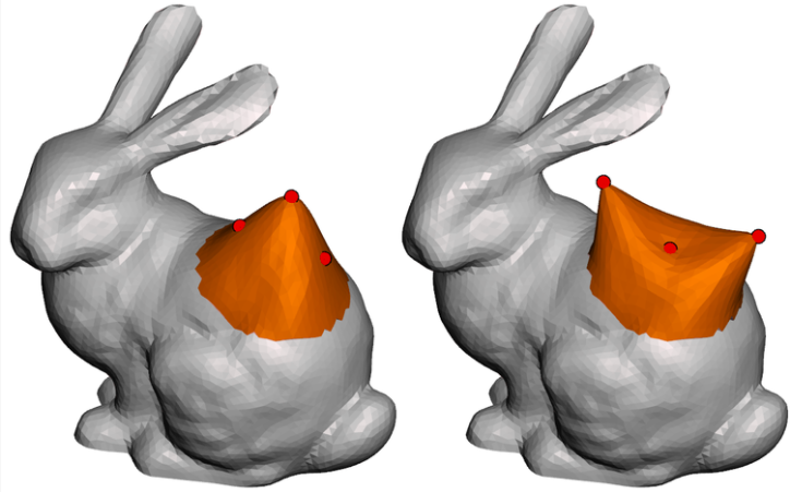

The power of Warp really comes from setting up sets of control points which allow you to create controllable deformations. In the example below we have added two more control points to the image above, and then moved all three to create a more complex shape.

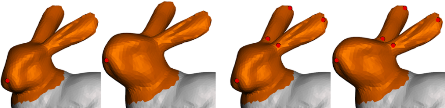

Note that the effect of each control point is not strictly localized. In the leftmost image below we have added a single control point and then moved it upwards. Notice how the entire selection has moved upwards, including the tips of the ears, quite far from the nose. We can add more points to pin down the ears, limiting their movement. However, ultimately each control point affects the entire surface, so the entire selected area will change slightly.

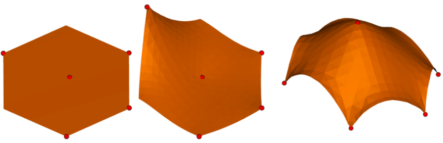

Warp also works with open boundaries. In the example below, we have a meshed hexagon on the left. By dropping a few constraint points, we can deform it into a different shape. This can be used to create quite interesting forms, as shown on the right. Note that currently it is not possible to deform the interior while keeping the boundary fixed.
