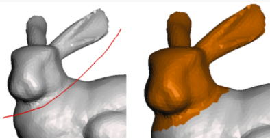

There are two modes to the lasso:
In the polygonal lasso, the resulting selection will be all triangles whose vertices are fully within the lasso. However in the freeform lasso, the curve does not have to be closed, as shown on the right. In this case you can think of the curve as "cutting" the model into two sides, and the selection is determined as the side which has the smaller number of faces. This may sometimes select the "wrong" side, which you can quickly correct with the Invert (i) or Invert Connected (shift-i) hotkeys.
