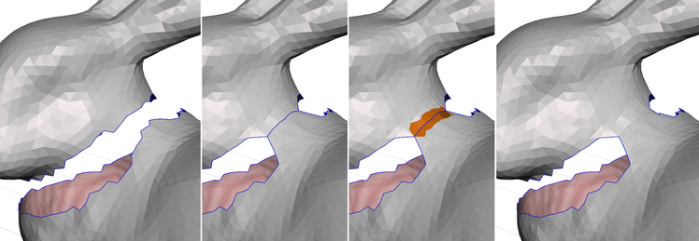

The image below shows an example of this workflow, that you can easily try yourself on the Bunny model. On the left is a large hole that could not be filled directly. In the image second from left, we use the ZipperEdge brush to pull the two sides together. Then we select on each side of this crack, and use Weld Boundaries to remove the crack in the rightmost image.
