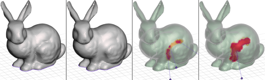

The image below shows two slightly different bunny meshes in the left two images. Then we show the result of the Deviation tool at 0.5mm and 0.25mm. Areas that are close to the Max Deviation are highlighted in yellow, increasing to red as the deviation reaches the threshold. Above the threshold, the triangles are colored dark red with a boundary highlight, and a stick-ball marker identifies each separate region. You can left-click on the ball associated with a region to automatically start the Select Tool with these triangles selected.
