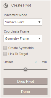

The Create Pivot tool is used to add Pivot objects to the scene. Pivots are useful in many contexts, so we have provided a large number of pivot placement options.
The hotkey to start the Create Pivot tool is 5.
The individual Placement Mode and Coordinate Frame options are discussed below.
To place a pair of symmetric pivots, enable Create Symmetric. Note that if you wish to change the symmetry plane, you can do so in the Sculpt tool.
When Link To Target is enabled, the created pivot will be linked to the object it is being placed on. When this object is transformed, the position of the pivot will be automatically transformed as well. Hence, the pivot "stays with" the linked target object.
The Offset slider pushes the pivot location in or out of the object along the pivot frame normal.
In modes where you interactively place the pivot, use left-click-drag to do so. In some modes the pivot has a single location and so clicking is not necessary. In either case, the pivot you see is only a preview. To actually add the pivot you must click Drop Pivot or hit the a hotkey.

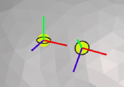

By default, each Placement Mode defines a specific frame orientation. This is the Geometry Frame. However, you can also choose to assign the World Frame to the created pivots, in which case the pivot axes are aligned to the XYZ axes. The figure below shows these two options. In addition, you can assign the Eye Ray Frame to the pivot. In this frame, the Y (green) axis is aligned with the eye-ray through the pixel under the cursor, and the blue axis is aligned to point directly to the left (the red axis is then determined by orthogonality, and generally points towards the bottom of the screen).
