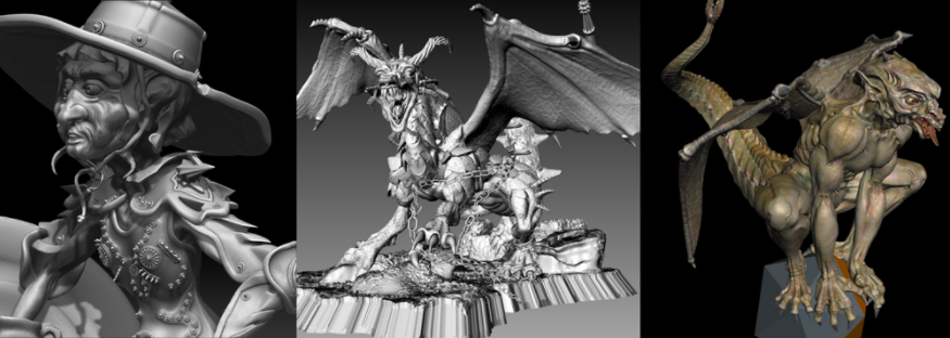

Meshmixer's 3D sculpting tools are somewhat basic compared to higher-end tools like Mudbox and ZBrush; however, because they are combined with our dynamic remeshing infrastructure, it is possible to create very detailed surfaces with much lower poly counts. The images below were posted on our forum by user MagWeb, see Mixed Meshes for more amazing examples.

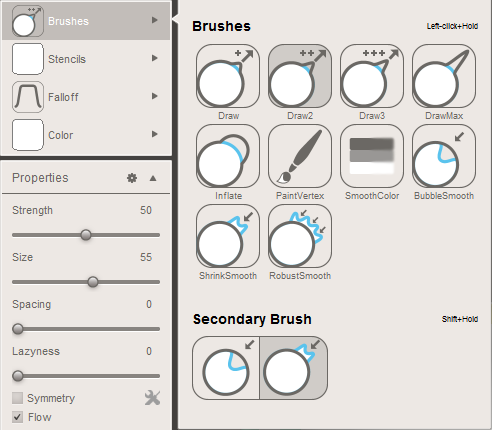

In both Volume and Surface brush modes, there is a concept of a Primary and Secondary Operation. In the Brushes flyout panels, you will see the list of possible Secondary Operations at the bottom, as shown below for the Surface brush. Currently the only options for Secondary Operations are different Smoothing brushes.
To use the Secondary Operation you hold down the Shift key while brushing. Note that it is possible to toggle between the primary and secondary brush within a single brush stroke, although it is usually easier to start a separate stroke.
Note that when you switch to the secondary brush, the values in the property panel change. This is because each Brush has its own set of current parameters, as described above.

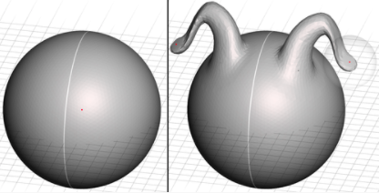

Both the Volume and Surface brushes have a Symmetry checkbox. When symmetry is enabled, a white line will appear on your model. A brush stroke applied on one side of the line will be mirrored on the other, as in the image below. The hotkey Shift+s toggles Symmetry on and off.

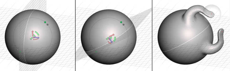

In this mode you can use the 3D transformation widget to move and rotate the symmetry plane to a different location. In addition, if you have Pivots defined in the scene, you can set the symmetry plane to the pivot by left-clicking, and repeatedly left-clicking to cycle through the 3 pivot axes. The Reset Symmetry Plane button restores the default plane location. Once you Accept the current location, you are returned to the Brushing mode, with the new symmetry plane active. See the example below. Note that the symmetry plane is shared between all tools, so if you change the plane in a Sculpt brush, the planes used in the Select and Create Pivot tools are also updated.

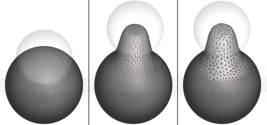

The Enable Refinement toggle allows you to completely enable or disable refinement. You can also do this with the r hotkey. Refinement is enabled by default for all Operations except the Move brush. The example below shows the effect of a brush stroke with refinement disabled (middle) and enabled (right). When disabled, the mesh vertices are moved by the brush, but the mesh connectivity does not change. So, triangles are stretched. With refinement enabled, we dynamically remesh the surface during your brush stroke, to try to maintain a reasonable triangle quality.

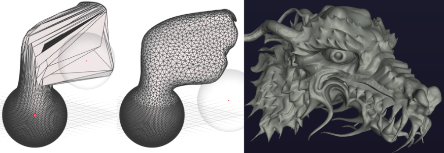

In the example above, the refinement-disabled stroke creates a more pleasing surface, which would be more obvious with the wireframe disabled. It is smoother compared to the refined alternative. However, the advantage of refinement is that you can continue to sculpt and the mesh will maintain reasonable quality. We have done this below, again comparing no-refinement (left) with refinement (middle). it is obvious that without refinement, we can only deform the surface so far before it becomes impossible to add more detail, while with refinement you can continue to add detail indefinitely. The image below-right was sculpted starting from a sphere!
In fact time and available memory are the only limits to the complexity you can add to an initial shape. This is the main power of Meshmixer's sculpting brushes, which will allow you to create very detailed models without having to worry about technical details of subdivision levels, etc. The trade-off is that you have to do some more work to achieve smooth surfaces, because the brush strokes are inherently not as smooth as the Multiresolution sculpting used in Mudbox and ZBrush.

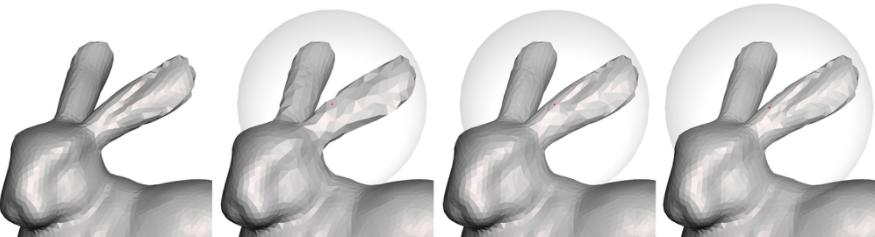

Finally, when Adaptivity is not zero, then instead of regular remeshing we use adaptive remeshing, like Adaptive Density mode of the Remesh tool. This primarily affects the Reduce/edge-collapse aspects of the remeshing. As Adaptivity increases, we try harder to preserve the surface shape as we collapse it, so that "important" small edges are not collapsed. Although this parameter defaults to zero, if you are working with large brushes you may need to increase it.
The example below shows the effect of Adaptivity. In each of the right 3 images, a single brush stamp has been applied, which results in one round of remeshing. In the left-middle image, Adaptivity is zero, and the large brush size, and hence large target edge length causes the ear to be significantly resampled, and details are lost. In the next two images Adaptivity is 25 and 50, and you can see that details are increasingly preserved.
Adaptivity is a recent addition to our Sculpting tools, and although it is quite helpful, you may need to experiment to get a feel for how to use this setting.
