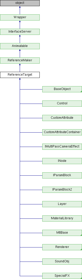

ReferenceTarget Class Reference
Class Description
A scene entity that is being observed by other scene entities.
+ Inheritance diagram for ReferenceTarget:
