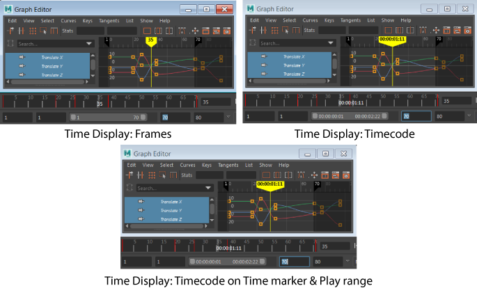

- Time Display
Select what format Time information appears on the Time Marker:
- Frames: Displays frames on all time rulers, current time markers, and input fields which display or accept time.
- Timecode: Displays video standard timecode on all time rulers, current time markers, and input fields which display or accept time.
- Timecode and frames on Time Marker: Displays video standard timecode on timemarkers while time rulers shown frames. This is the legacy display when
Timecode is set in the in the
Time Slider options in the
Time Slider Preferences
