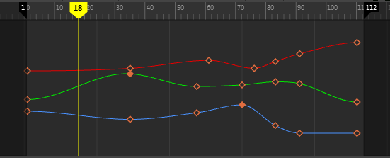

In order to operate on a component of an animation curve, you must make it viewable by loading it into the Graph Editor. By default, objects selected in a scene view are automatically loaded in the Graph Editor. Keys are represented in the graph view as orange squares, and when selected, they are highlighted white.
Customize the default key color in the Preferences menu Color Settings.
Sets keys to be visible at all times in the graph view of the Graph Editor.
Hides keys in the graph view. Because keys are no longer available for picking, you can no longer edit them.
Sets keys to be available only when you select the curve they are associated with.
