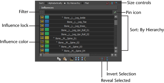

This area displays a list of all influences bound to the selected mesh. For example, all joints that influence skin weights for a selected character mesh.
Within the Influences list, you can use the following controls.
Enter text to filter the influences that display in the list. This can make it easier to locate and select influences you want to work with, especially if you have a complex rig. For example, enter r_* to list only those influences that have the prefix r_.
Pins the influence list to display only the selected influences.
Lets you lock and unlock each influence from receiving weight as you paint.
Opens the Influence color window, which lets you assign a new color to the selected influence.
Click to copy the weight value of a selected vertex. See Copy smooth skin weights.
Click to paste a copied vertex weight value to other selected vertices.
Click to fix selected vertices that have weights causing undesirable deformation on the mesh. Maya assigns the selected vertices with the same weight values as their neighboring vertices, resulting in smoother deformation. See Fix smooth weights.
Click to move the weight values of selected vertices from the first selected (source) influence to other selected (target) influence(s). See also Move weights to other influences.
When you click the Move weights button (or select Skin > Edit Smooth Skin > Move Weights To Influences), the weight values of the selected vertices are removed from the selected source influence and re-assigned to any selected target influence(s).
Click to select all influences that affect the selected vertices. This can help you troubleshoot areas of the mesh where you find unexpected deformations.
Click to quickly reverse which influences are selected in the list. This option is useful in conjunction with the Influences list hold and un-hold buttons.
For example, select only those influences you want to work with, then click Invert Selection to change your selection to all other influences in the list. You can then click to hold all other influences.
Click to automatically scroll the Influences list to display the selected influence. This can be helpful when working with a complex character that has many influences.

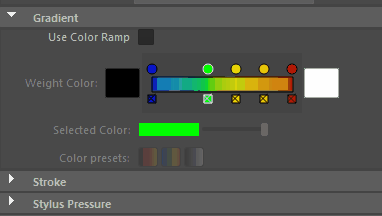

Different Color Ramp types
When Use color ramp is on, you can use the Weight Color ramp and Selected Color options to customize the color ramp. You can also select one of the Color Preset options.
Click to open the Color Chooser window and set a new color for a selected part of the color ramp. Only available when Use color ramp is on.
Select from three pre-defined color ramp options.
