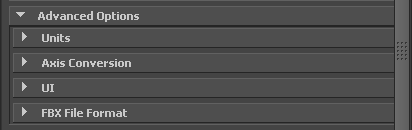

Extra Options
Use scene name

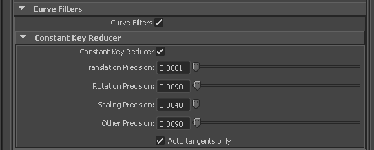

Curve filters
Activate Curve filters to apply animation filters to function curves during the export process.

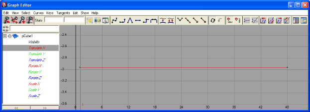

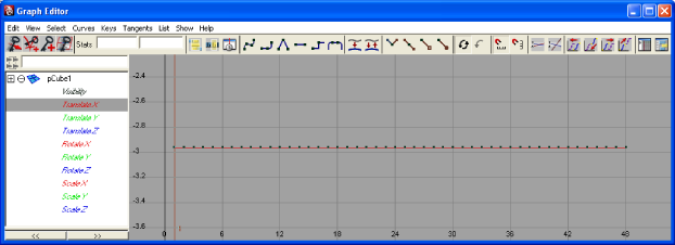

Constant Key Reducer
Activate the Constant Key Reducer filter to remove redundant keys. Redundant keys are keys that have the same value, which are equivalent to flat horizontal interpolations on a curve. Redundant keys are often a result of a resampled FCurve before filtering.
Before:
Resampled FCurve before filtering
After:
Filtered FCurve with redundant keys removed (based on Threshold setting)
You can set specific thresholds for each type of transform. Translation Precision, Rotation Precision, Scaling Precision, and Other. Other includes transforms like Blend Shapes and custom attribute curves.
The default values are:
Values represent generic units. This is why you may need to modify threshold values in relation to the world scale of your scene, for example with very large or small scale scenes.
If you use this filter to eliminate noise, for example, from motion capture data, then you may need to modify values.
Setting Description
Translation Precision Threshold for translation curves in generic units.
Rotation Precision Threshold for rotation curves in generic units.
Scaling Precision Threshold for Scaling curves in generic units.
Other Precision Threshold for other curves in generic units.
Auto tangents only This option ensures that only “auto” key types are filtered. Otherwise, keys with interpolation values greater than a certain threshold may get deleted.

Advanced options
The Advanced Options section primarily contains additional options that let you modify the default plug-in behavior. In most cases, you do not need to modify these options to have a successful export. The section also holds additional settings specific to the Collada file type.

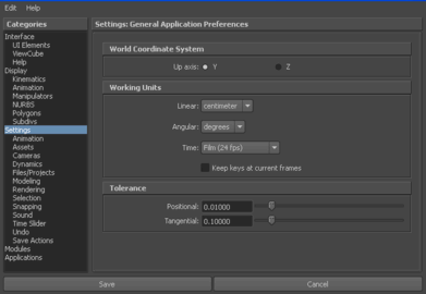

Units
The Units option lets you view the conversion factor (scaling value) the plug-in uses as well as modify the conversion units.
Note: This does not change the System unit settings in Maya.
Scale Factor
Displays the conversion value or Scale Factor that the plug-in applies to the entire scene during export. By default, the Maya FBX plug-in uses the system units set in the host application to determine what units to use to export the FBX file. This means that the default export Scale Factor is always 1.0, and the plug-in applies no unit scale conversion during the export process.
You can modify what units the Maya FBX plug-in uses to export your scene if you change the File units converted to option. If you change the File units converted to option, you modify the Scale Factor value and units applied to the exported data.
Automatic option
Activate the Automatic option if you want the Maya FBX plug-in to automatically identify and set the units of the destination file to match units of the host application.
When you activate Automatic, the Scene units converted to option is disabled, although it shows the resolved unit & Scale Factor. If you disable the Automatic option, the Scene units converted to option becomes available.
When Automatic is active, the File Units will match the system units, and the plug-in applies no conversion. The displayed Scale Factor is 1.0 in this case.
Use this menu to specify the units to which you want to convert your exported scene. Modifying this setting directly affects the Scale Factor value applied to the exported data.
The plug-in determines the default units by looking at the Maya System Units option in the Window > Settings/Preferences > Preferences > Settings category.
In the FBX UI, the displayed Scale Factor uses the FBX Unit setting for its calculation. The plug-in determines the FBX Unit setting from the host application system units.
On export, the plug-in applies no default scaling since the export and system units match. This results in a Scale factor of 1.0.
Note: Verify the system units your Maya scene uses so that you can control whether the plug-in needs to scale your scene. This way, it exports with the units you want. Maya lets you change the System Units without affecting the scale of your scene. Changing the system unit in Maya avoids scaling on export when not required.

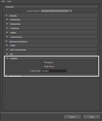

Collada
The Collada options only appear in the UI when you select the DAE_FBX file type from the file browser when you export.
Note: When you export in Collada format, textures are not embedded, even when the Embed Textures option is activated. See Embed Media in the File Type Specific options topic.
Triangulate
This option automatically tessellates the exported polygon geometry.
Single matrix
This option ensures that there is only a single animation matrix for each node/object by baking all animation matrices into one.
Frame Rate
Use this field to set the frame rate of the scene on export.
