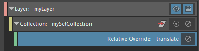

Add the set to the collection, and set the Collection Filters drop-down list to Sets, then drag and drop the attribute to the collection Property Editor to create the override.
If you are overriding attributes on the transform nodes or on their children, you can also leave the
Collection Filters at its default setting of
Transforms in order to create the override.
It is not necessary to manually create subcollections to override children of transform nodes.
In this example, set1 contains pSphere1 and pCylinder1.

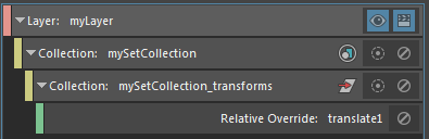

Create a collection and select Sets from the Collection Filters drop-down list.
Add set1 by selecting it and clicking Add in the Property Editor, or by entering an expression. See Create a collection for your render layer.
Drag and drop the attribute (for example, Translate) from the transform node to the collection Property Editor.
A subcollection is automatically created that contains the transform nodes of the Set members. Click View All in the collection Property Editor to verify the collection membership.

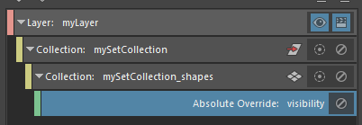

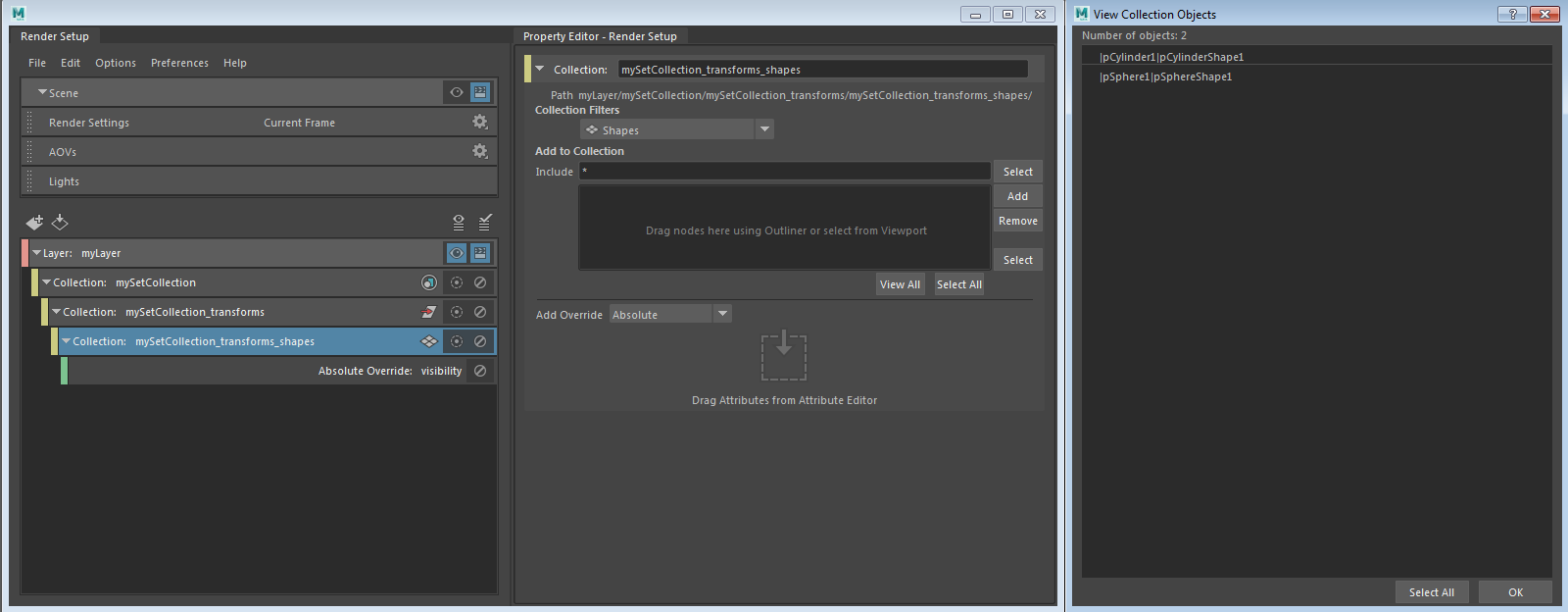

Drag and drop the attribute (for example, Visibility) from the shape node to the collection Property Editor.
A subcollection is automatically created that contains the transform nodes of the Set members. Within this subcollection, another subcollection is also created that contains the shape nodes of the set members. Click View All in the collection Property Editor to verify the collection membership.

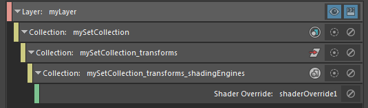

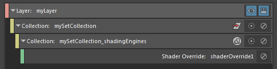

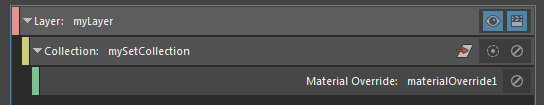

Right-click the collection of objects and select Create Material Override.
A subcollection is automatically created that contains the transform nodes of the Set members, as well as a corresponding override.
Select the material override, and click the map button beside the Override Material attribute in the Property Editor to assign a new material to the objects in the collection. To assign an existing material instead, middle-drag and drop from the Hypershade to the Override Material attribute.
You can create shader overrides using a similar workflow. When you select Create Shader Override, a subcollection is automatically created that contains the transform nodes of the Set members. Within this subcollection, another subcollection is also created that contains the shading group nodes of the set members.

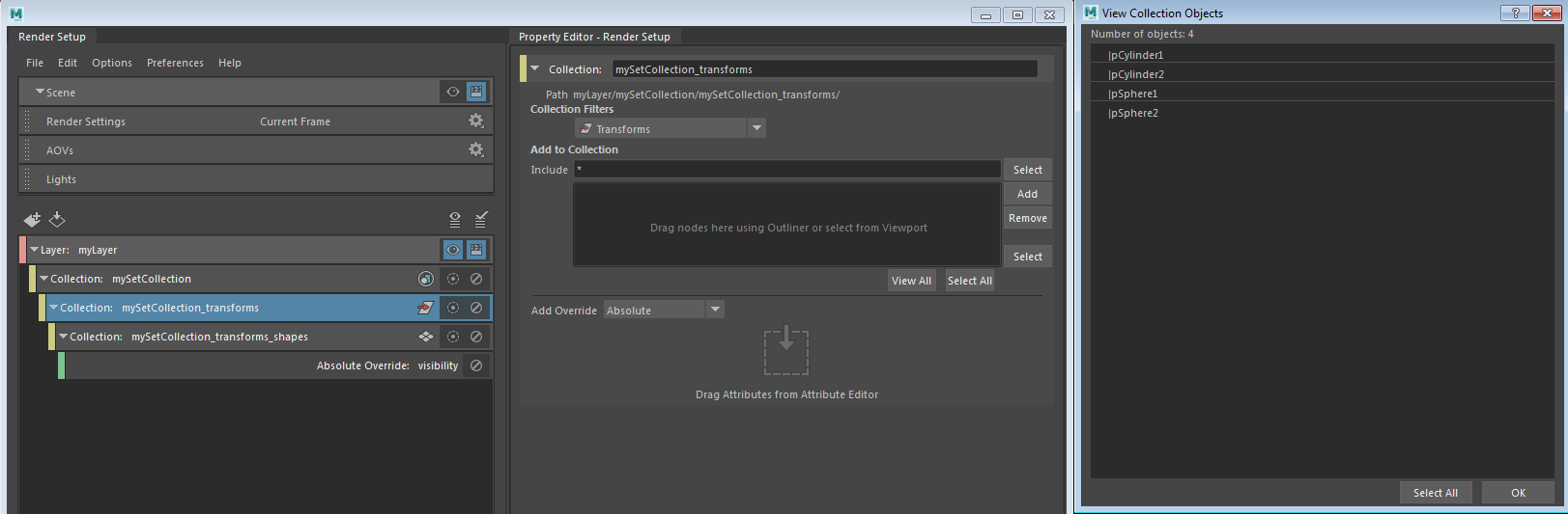

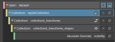

Add the parent set to the collection to override its members and the members of its child set.
In this example, set1 contains pSphere1 and pCylinder1. set2 is a subset of set1 and contains pSphere2 and pCylinder2.
To override both spheres and both cylinders, it is only necessary to add set1 to the collection. It is not necessary to explicitly add set2. This principle applies regardless of whether your
Collection Filters is set to
Transforms or to
Sets.
In this example, set1 is added to mySetCollection, and the Collection Filters set to Sets. Upon creating an override on the Visibility attribute, a mySetCollection_transforms subcollection is created, and a mySetCollection_transforms_shapes subcollection created within it. Click View All on either subcollection to see that its membership includes both spheres and both cylinders.
