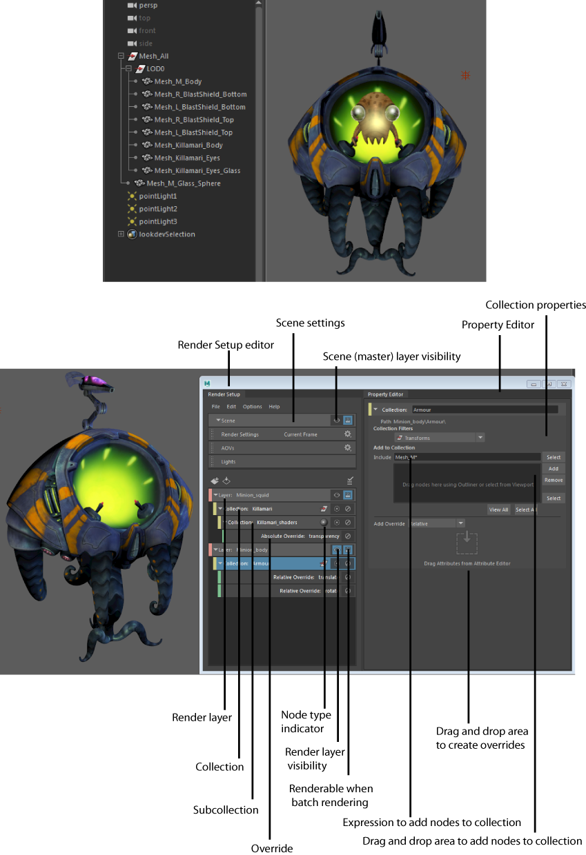

Click
		 on the status line to open the
		Render Setup editor. The
		Render Setup workspace window appears, with the
		Render Setup editor on the left and the
		Property Editor on the right. The
		Render Setup editor allows you to create layers, collections and overrides, while the
		Property Editor allows you to set their corresponding values. In addition, the
		Render Setup editor allows you to access your scene (master layer) settings via its
		Scene tab.

In this example, the first layer has a collection that contains the squid character. An override is applied on the Transparency attribute of the shaders; thus a Killamari_shaders subcollection is automatically created. The second layer has a collection that contains the armor of the Minion character, and a relative override is applied to its Rotate attribute, and another relative override is applied to its Translate attribute.
