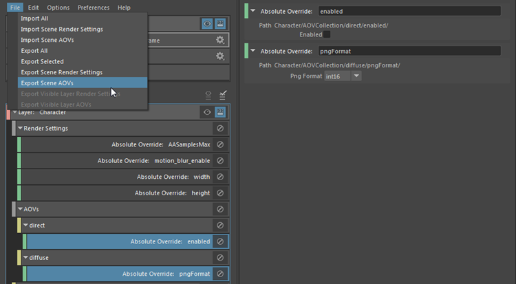

In this example, selecting File > Export Scene AOVs creates a .json that does not include the override values: the direct AOV remains enabled, and the Png Format for the diffuse AOV is set to int8, as in the master layer.
