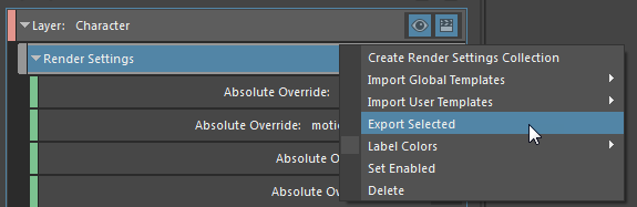

The .json created via Export Selected only exports the information regarding the selected item. For example, if you export a render layer, then only the layer, its collections (including the Render Settings collection), and their overrides are exported. The scene Render Settings are not exported.

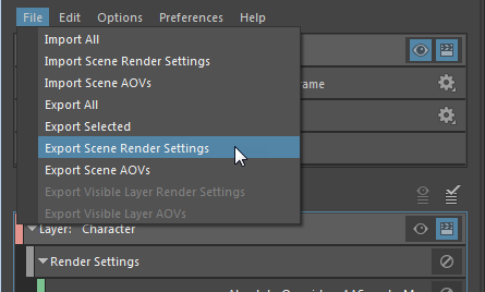

To export the scene Render Settings, select File > Export Scene Render Settings in the Render Setup editor. Only the Render Settings are exported; overrides are not included in the .json file.
Import this .json via File > Import Scene Render Settings in the Render Setup editor. The renderer you have currently selected must be the same as the one saved in the .json file; otherwise, the import fails.

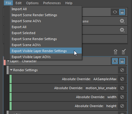

You can export the Render Settings of your visible layer as a preset, and import this .json in another scene. All Render Settings override values applied in this layer are included in the .json. See Export visible layer Render Settings and AOVs.
To export, select File > Export Visible Layer Render Settings.
To import, select File > Import Scene Render Settings. The renderer in the destination scene must be the same as the one saved in the .json file; otherwise, the import fails.
