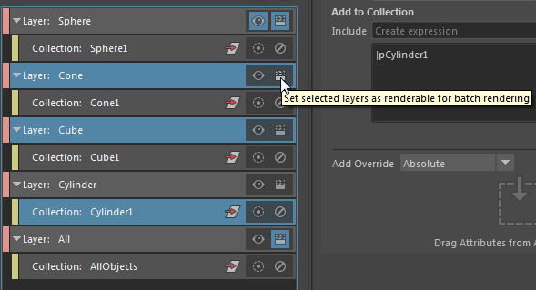

You can
simultaneously set multiple layers to be batch renderable by selecting the layers and clicking
. Clicking the icon in the
state toggles it on and sets all selected layers to renderable, while clicking the icon in the
state toggles it off and sets all selected layers to non-renderable. For more clarity, mouse over the icon after selecting the layers, and a tooltip appears, indicating the state to which you are setting the layers.
You must select the layer itself to change its renderable state. You cannot select only its collections or overrides.
In this example, clicking
sets the Cone and Cube layers to be renderable. The Cylinder layer remains non-renderable as only its collection is selected, and not the layer itself.

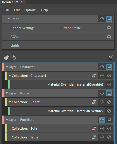

Only the currently visible render layer, denoted by the
icon, is rendered into the
Render View via interactive rendering. This is true regardless of whether the layer is set to renderable via the
icon. This render result is saved into the
/tmp folder of your image output directory.
In this example, the masterLayer, Character and Room layers are rendered during batch render as they are denoted as renderable by the
icon.
Only the Furniture layer is rendered during interactive rendering as it is set to visible. This is true even though the layer is set to non-renderable
for batch rendering.
