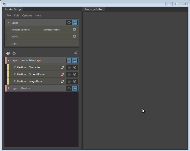

Click the
Scene
icon at the top of the
Render Setup editor to switch to the scene (master) layer, then double-click the
Render Settings tab to open the
Render Settings window. This opens the
Render Settings for your scene.
The range of frames being rendered is also displayed. It may indicate Current Frame, or Frame 1-10, for example, if you have set a Start frame and an End frame.
Double-click the Render Settings tab on the scene layer (or on any of the render layers) to open the Render Settings window.

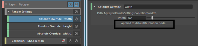

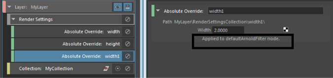

Select any Render Settings override, and the Property Editor indicates the node to which it is applied; for example: Applied to defaultResolution node. This indicator appears on all Render Settings overrides created since Maya 2017 Update 3.
This indicator may be helpful in cases when you create overrides on two or more attributes with the same name on different nodes.
For example, in this case, there are two overrides named width. The Property Editor indicates Applied to defaultResolution node for the former:
and Applied to defaultArnoldFilter node for the latter for easy identification.
