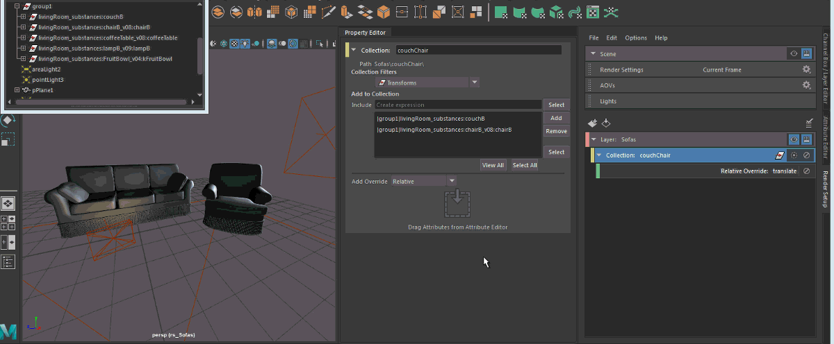

When creating an override to transform objects, you can set the override values in two ways. You can enter the exact values in the Property Editor, or you can select your collection members and transform them in the viewport to set the values.
In the collection Property Editor, click Select All to select the transform nodes of all the objects in the collection.
By default, your collection includes only transform nodes, which determine the objects you see in the viewport when a layer is visible.
Alternatively, if you have a lot of objects in the layer, you can select only the transform node of any one of the collection members.
In this example, the couch and the chair are added to the collection by selecting their parent nodes and clicking Add.

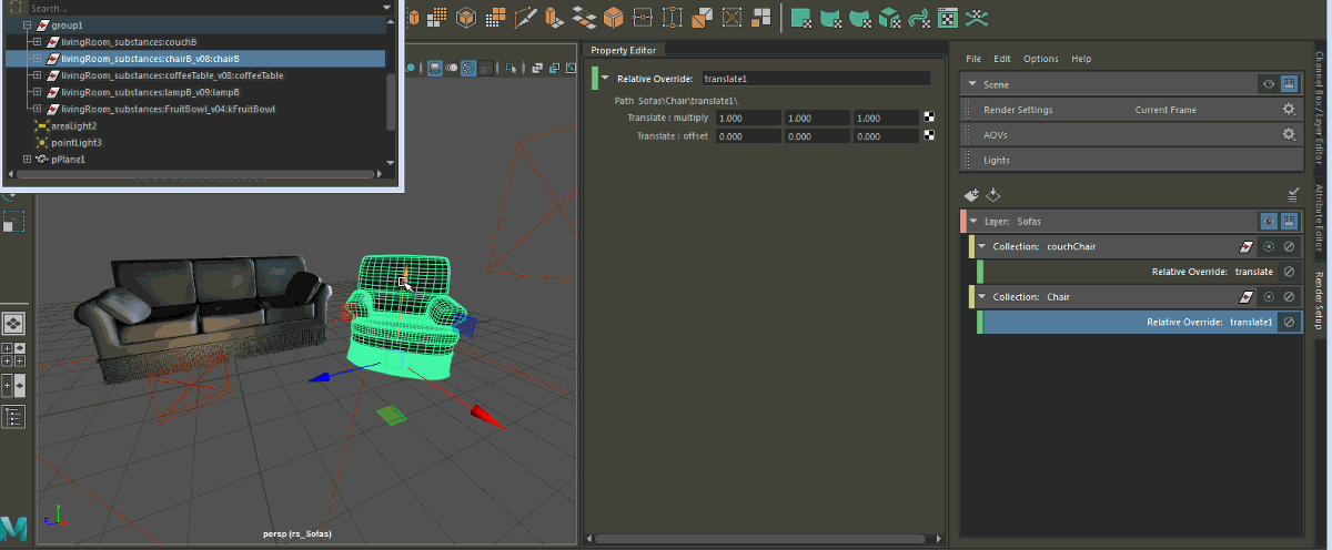

The parent node of the chair is then selected and translated in the viewport. Both the couch and chair move as a result, and the translate override values update accordingly in the Property Editor.

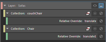

Overrides are applied top-down, as discussed in Create overrides for a collection by entering values in the Property Editor. When multiple overrides exist on the same attribute for the same objects, the override that appears furthest down in the list is the one with the highest priority.
In this example, a translate override is created for the collection containing a chair, and a translate override is also created for the collection that contains both the couch and the chair. If you select the chair and manipulate it in the viewport, it affects the translate override for the Chair collection, since it appears further down in the list and is therefore the one with the higher priority.
To affect the translate override for the couchChair collection instead, disable the higher priority override.
