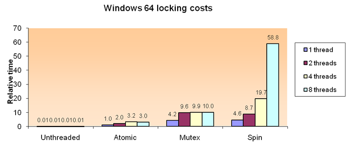

The following are the performance numbers for the cost of spin and mutex locks and atomic operations on Windows 64. (Other platforms are similar with the exception of OSX that mutex is much slower.) The plug-in to generate these numbers is called threadingLockTests, and is shipped with Maya as a sample plug-in for you to test performance on your own system. It requires a compiler that supports OpenMP. Note that this plug-in is an extreme case as the code does very little actual parallel work within the locked region. However it does give an indication of the relative cost of these locks under heavy contention. (A contended lock is one where another thread attempts to gain the lock that is already held by one thread. Having more running threads increases the chances of lock contention dramatically. Performance suffers significantly if there is high contention.)
Note the benefit of atomic operations over the various mutex locks. Also note that code without any locking is far faster than even the atomic implementation. Clearly it is best to avoid locks wherever possible. If not, atomic operations should be used, and only if this is not possible should full mutex or spin locks be used.
