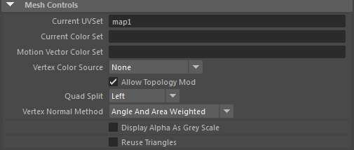

By default, the logic used for polygonal shapes attempt to provide the best shaped triangles. However, for remapping, the overriding goal is to obtain predictability as to how the splitting occurs. As such, the quadSplit attribute on mesh shapes can be set to improve predictability.
The quadSplit option determines how quads are split into two triangles. If Left is selected, then the new edge will be between the 2nd and 4th vertex, while Right splits between the 1st and 4th vertex. Best Shape attempts to pick the best split based on the shape of the quad, but this may change as the shape deforms across an animation.
Thus, selecting either a Left or Right split will provide greater predictability.

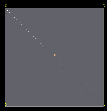

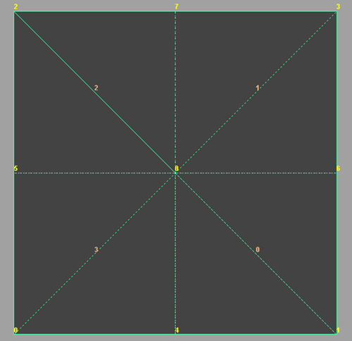

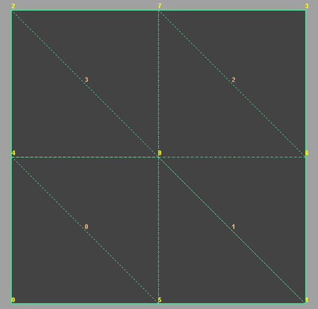

A Left split is shown in the images below. The dotted line shows where the split occurred.
If Best Shape is still desired, the reference logic for a quad is given below. The general algorithm handles general N-sided polygons, which may have holes, but is not included here.

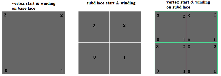

We refer to the original geometry as the base geometry. For example, an original face is a base face.

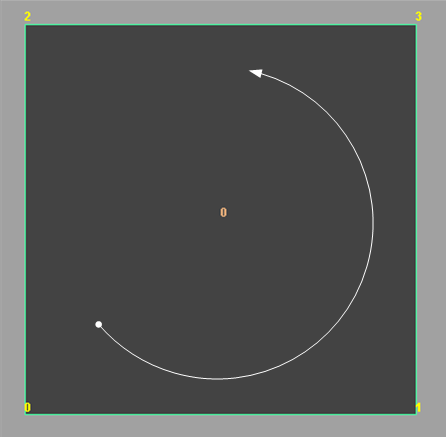

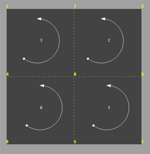

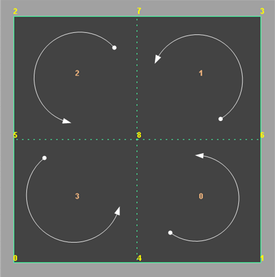

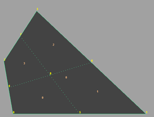

The figure above shows a base face (left image) and the start and winding order of the subdivided faces and vertices when 1 level of subdivision is applied (center and right images).
Levels closer to the base level are considered as being higher. The subdivided face ordering is thus shown to be consistent with higher levels. The start face is in the bottom-left corner which aligns to the start vertex on the base face. Similarly, the vertices on the subdivided faces also start from the bottom-left corner. The winding order is always counter-clockwise (CCW).
Assuming the origin of the local UV is located at vertex 0 of the base face, it is possible to deduce the local UV's of the vertices on the subdivided faces.

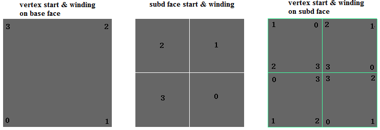

The logic for Maya legacy subdivision is a little more complex.
The figure above shows a base face (left) and the start and winding order of the subdivided faces and vertices when 1 level of subdivision is applied (center and right images). The start of the subdivided face aligns to the second (index = 1) vertex on the base face, while the starting vertex continues to shift accordingly, based on the subdivided face number.
The following is the sample code. The sections of the code that differ from that of the OpenSubdiv algorithm is highlighted in bold.

The render time buffers would look like this:
| Vertex Id (CCW winding) | Face id | Local UV |
| 0 | 0 | (0, 0) |
| 1 | 0 | (0, 1) |
| 3 | 0 | (1, 1) |
| 2 | 0 | (1, 0) |
The topology shown above demonstrates one level of smoothing using OpenSubdiv. The start and winding order per sub-face and sub vertex is consistent for all levels with the base face.
The data buffers would appear as follows. Note that:
The Sub-Face Id column is added to show its correlation to the topology shown above, but is not provided as a separate vertex buffer.
Vertex ids 6 to 8 are not part of the base mesh.
Vertex ids 4, 5, 6, 7, 8 are vertices introduced as part of smoothing. The base mesh has vertices 0, 1, 2, 3. The dotted lines show where the subdivision occurred due to the smoothing operation.
The local parameterization simply provides values to show the interpolation relative to the base vertices, and is not related to the actual placement of the vertex within the base face. For example, if vertex 8 was actually positioned close to vertex 0, the local UV value would still be (0.5,0.5), such as in this geometry:
| Vertex Id (CCW) | Face Id | Sub-Face Id | Local UV |
| 0 | 0 | 0 | (0, 0) |
| 5 | 0 | 0 | (0, 0.5) |
| 8 | 0 | 0 | (0.5, 0.5) |
| 4 | 0 | 0 | (0.5, 0) |
| 5 | 0 | 1 | (0, 0.5) |
| 1 | 0 | 1 | (0, 1) |
| 6 | 0 | 1 | (0.5, 1) |
| 8 | 0 | 1 | (0.5, 0.5) |
| 8 | 0 | 2 | (0.5, 0.5) |
| 6 | 0 | 2 | (0.5, 1) |
| 3 | 0 | 2 | (1, 1) |
| 7 | 0 | 2 | (1, 0.5) |
| 4 | 0 | 3 | (0.5, 0) |
| 8 | 0 | 3 | (0.5, 0.5) |
| 7 | 0 | 3 | (1, 0.5) |
| 2 | 0 | 3 | (1, 0) |
The provided index buffer can be used to access information per triangle.
As noted, the triangle split may not match the value specified for the quadSpit attribute on the polygonal shape. If we are given this triangulation:
Then the index buffer would look something like this.

The topology above demonstrates one level of smoothing using the Legacy Catmull-Clark subdivision method. The shifting of the start of sub-faces and sub-vertices can be seen.
The data buffers would be as follows. As in Example 2, the Sub-Face Id column is added to show its correlation to the topology shown above, and is not provided as a buffer.
The shift in sub-face and sub-vertex start positions reflects what is shown in the diagram.
| 4 | 0 | 0 | (0, 0.5) |
| 1 | 0 | 0 | (0, 1) |
| 6 | 0 | 0 | (0.5, 1) |
| 3 | 0 | 1 | (1, 1) |
| 7 | 0 | 1 | (1, 0.5) |
| 2 | 0 | 2 | (1, 0) |
| 5 | 0 | 2 | (0.5, 0) |
| 5 | 0 | 3 | (0.5, 0) |
| 0 | 0 | 3 | (0, 0) |
| 4 | 0 | 3 | (0, 0.5) |
Legacy Catmull-Clark has different indexing than OpenSubdiv Catmull-Clark, based on the fact that its start face and start vertices differ. Therefore, using the same example, the triangulation appears as follows:
The indexing would be as follows:
| Triangle number | Vertex Id |
| 0 | 4 |
| 0 | 1 |
| 0 | 8 |
| 1 | 8 |
| 1 | 1 |
| 1 | 6 |
| 2 | 6 |
| 2 | 3 |
| 2 | 8 |
| 3 | 8 |
| 3 | 3 |
| 3 | 7 |
| 4 | 7 |
| 4 | 2 |
| 4 | 8 |
| 5 | 8 |
| 5 | 2 |
| 5 | 5 |
| 6 | 5 |
| 6 | 0 |
| 6 | 8 |
| 7 | 8 |
| 7 | 0 |
| 7 | 4 |
The following image shows a subdivision of level 2 using the Legacy Catmull-Clark method, and illustrates a repeat of the subdivision pattern.
With the following data trace from the hwPhongShader plug-in:
