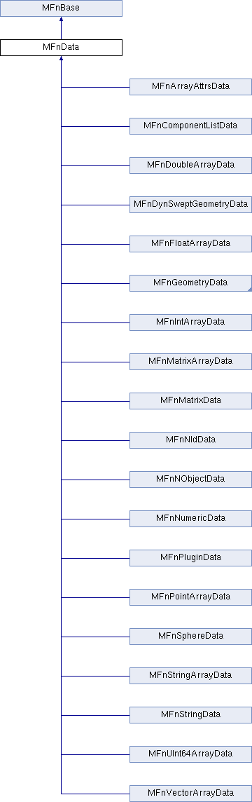

Inheritance diagram for MFnData:Public Types | |

Parent class for dependency graph data function sets.
MFnData is the parent class for all dependency graph data function sets. Conceptually, data objects are what flow through the connections in the dependency graph.
Each node in the dependency graph has a data block associated with it. The data block holds the data objects for all of the node's attributes (see MDataBlock). The data block is only available during the compute method of a node. A data handle (MDataHandle) can be created to access a particular attribute's data inside of the data block.
Once a data handle is obtained, it is possible to get the data object from it. This is only necessary for heavier data structures such as geometry or strings. Simple numeric data can be manipulated straight through the data handle.
