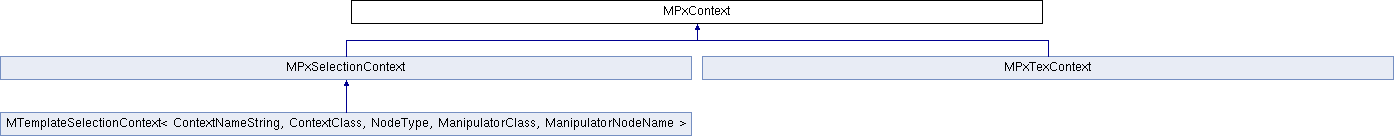

+ Inheritance diagram for MPxContext:

Reimplemented in MTemplateSelectionContext< ContextNameString, ContextClass, NodeType, ManipulatorClass, ManipulatorNodeName >.

Reimplemented in MPxTexContext, and MPxSelectionContext.
