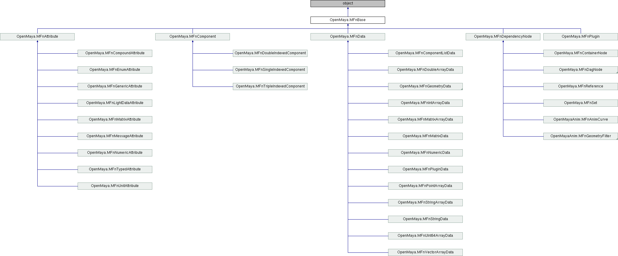

 Inheritance diagram for OpenMaya.MFnBase:
 Inheritance diagram for OpenMaya.MFnBase:| Public Member Functions | |
