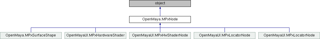

 Inheritance diagram for OpenMaya.MPxNode:
 Inheritance diagram for OpenMaya.MPxNode:| Public Member Functions | |

Base class for user defined dependency nodes.
